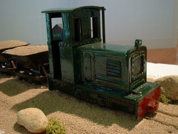

I am considering repainting my Bramble line diesel locomotive, because the finish is to glossy and I would like a different shade of green.
Is there a good way of stripping enamel paint from a resin kit without damaging the detail.

Steve's suggestion is to use brake fluid BUT there are two provisos.
Current fluids with the Silicon formula don't strip paint!
Some resins might be dissolved.
Your only option would seem to be to remove the roof and try brake fluid on that part. If the resin is damaged a piece of Venetian Blind will provide a suitable replacement.
Steve made a second suggestion which, I must admit, I don't think will work with what looks Enamel Paint (Humbrol?). Dunk the resin body into thinners.

Postby Steve Bennett » Tue Mar 03, 2009 12:08 pm
DON'T USE CELLULOSE THINNERS
Thought I had better get that in first, as it will dissolve the resin :(
As it happens, I have a Bramble Line loco which is almost identical sat on the shelf. Not mine, but like yours, is awaiting a repaint after it was hand painted with Humbrol enamels. Thought I would do a test after Gerry spoke to me yesterday.
I put the roof in some Acetone for a couple of hours and this was enough to soften the paint to the point where it could be rubbed off with a tissue. For removing from all the nooks and crannies, an old toothbrush will probably do the job. There is a drawback though, if the kit was assembled with Superglue, the acetone will also attack this and you could end up with the kit in it's original pieces.
Hope this helps.

Postby Steve Bennett » Tue Mar 03, 2009 2:50 pm
Mulderspants wrote:Thanks for the response, "the kit of parts" is not an issue, its not as though the kit is made of many parts :D
:lol: Thats true, it might even be easier to strip if it does fall apart :) .
The Acetone doesn't dissolve the paint, it just softens it really. It does make it easy to rub off though while it is still soft. If the paint starts to harden again, just put it back in the acetone for a while and have another go.
Also works with acrylics and shouldn't effect the resin, not so safe with styrene.
