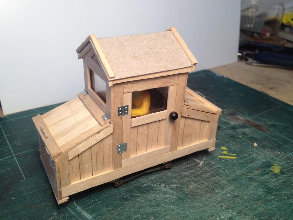

After a lifetime (?) of 009 modelling and a longish diversion into 0-16.5 I decided to dip my toe into the rarified pool that is GN15.
I was spurred towards this decision by a desire to enter a critter in the Dave Brewer Challenge at Expong this year and to use a different scale. So, with a chassis from an American switcher, which runs really well, I made a start.
The first picture shows the initial card mock-up to get the feel for, what is to me, an enormous size. I was quite pleased but realised the cab was too narrow. So, after modifying the dimensions, I've started on the sides, using coffee stirrers as I want it to have a very home-made, woody feel. So far so good.
I don't think I'll build a layout for it so may well sell it after the competition.

Postby Boghopper » Fri Sep 19, 2014 5:16 pm
Quite a bit of progress today. Not much to report about the construction method. Basically different width coffee stirrers and white wood glue with a piece of folded card for the roof. I've still to decide on what sort of ironwork to use but I think it's retaining the feel I was trying achieve.
I don't think this is new move, away from 009. I've no plans to build a GN15 layout. If this critter turns out as well as I hope, I'll be offering it for sale.

Postby Boghopper » Sun Sep 21, 2014 2:06 pm
Well I think I've gone as far as I can with the construction of the body. As the card roof represents roofing felt, I've glued a couple of battens on each side to make it look more like a shed.
Hinges on the door and the tops of the sloping hatches are made from the foil tray that dog food comes in. This is how:
A piece was cut, 6mm x 5mm. Using the bluntish end of a small chisel I pressed a groove in the centre of the reverse side. Turning it over, I pressed another groove, either side of the central one, thus forming a raised section. To form the screws I pressed four dimples with a rounded spike on the reverse side then gently flattened them on the front. This was repeated six times. The hinges on the lids were bent slightly then glued in place and the those on the door fixed flat. Finally a spherical map pin was used for the doorknob.
At the moment the body is a push fit on the chassis and may remain that way, perhaps with a little help from blu tac or double sided tape. I'm still undecided about buffers and couplings. All suggestions considered.
Also, I'm wondering how to get a weathered paint finish. There is, I think, an existing kit for what is called an 'Outhouse' loco, which has a lovely weather worn patina which I would like to achieve. What I may do is paint it with a mixture of thinned brown and silver and when the paint is dry, dry-brush with another colour. Again, any thoughts?
