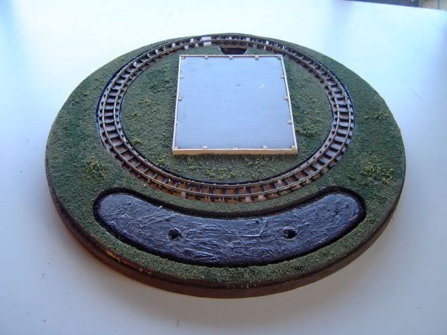

I've made a bit more progress today.
I UHU glued the n-gauge track to a piece of hardboard. This raises the track up a bit which helps with clearance and makes the following conversion a bit easier.
With a sharp chisel-bladed knife I removed every other sleeper. Using the spring clips to demark sections I took out every other sleeper in a section then superglued the remaining sleepers.
Then skipping the next section I took out the sleepers in the third section and so on. When I reached the start I took out the sleepers in the missed sections. Finally I removed the clips and removed the sleepers under them. This ensures that the track remains circular and every sleeper is superglued once and only once :roll:
The finished track compared with n-gauge and OO9 "crazy track.
And placed on Tetley Grange (Yes Steve I still have it :D )

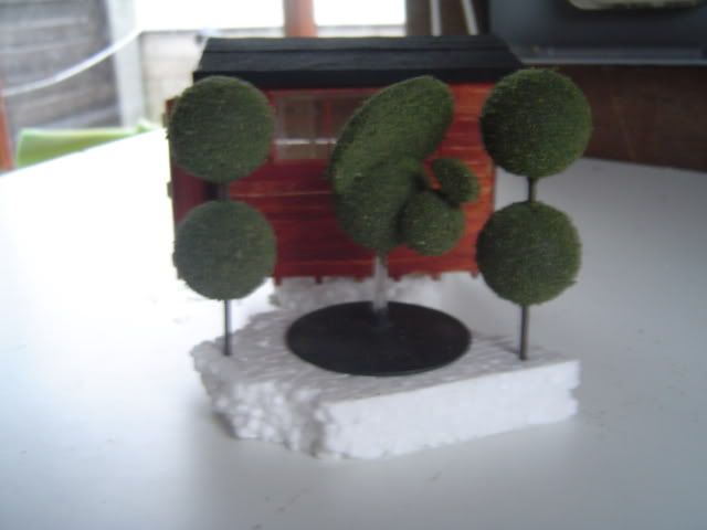

A bit of a diversion for me now. It's the first time that I've used Fimo and the first time I've attempted modern art.
The Vicar's wife has insisted that the hedge blocking the view of the shed was a bit plain despite the gardeners best effort at topiary (I won't tell you the gardeners response but you can rightly assume he was a little upset).
The front view
A side view
The hedge is growing at the moment, to be honest I'm not sure if it will work so I'll need your honest opinions on this. 8)
