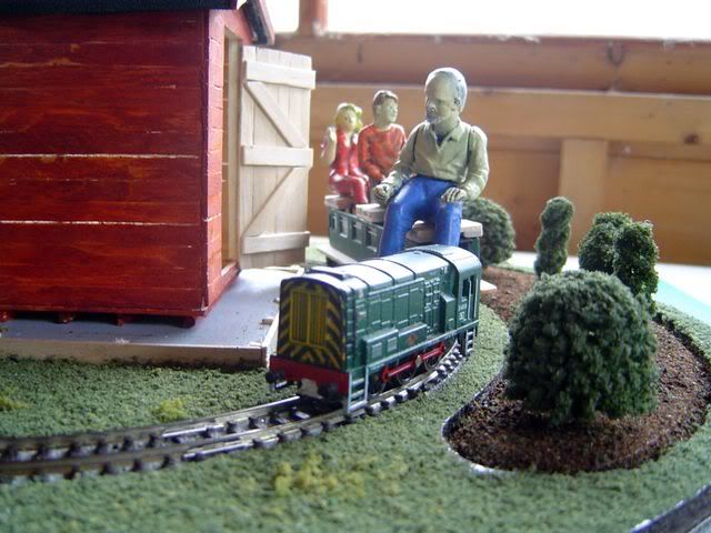

Tetley Grange started off when my Mrs stuck her head through my modelling shed, gave me the base of our wedding cake and asked me if I could build a layout on it :shock: :shock:
After a quick session with a compass and a can of Halford's "Rover Maple"
The plan required two main levels so a piece of foamcard was cut to shape and glued on with pva, making sure that the edges of the foam was well covered to ensure that it didn't melt when sprayed.
Next came the scenic stuff.
I had envisioned a garden setting so a lawn was laid using two colours of ground scatter and a flower bed was added with tea-bag leaves for mulch.
A concrete pad was laid out out foamcard with shuttering made out of coffee stirers and matchsticks.
Topiary was added. The outer two bushes are small model railway trees, the next two in are spiral pasta and the centre-piece is a bird sculpted out of blue-tac. These were then covered in pva and dunked in a tub of ground scatter and had further layers added using hair-spray to fix. More details of how to make topiary and conifers can be found here
Barry had kindly brought a section of Tomix track to the June meeting of The GnOrfolkers and I ordered some 104mm diameter track from Plaza-Japan on ebay as I hadn't time to hand lay.
Next add previously built shed :lol:
A better shot of the topiary
The above was all built last Sunday :shock:

Of course a miniature railway needs miniature rolling stock.
I had purchased a Grafar 08 a while ago for a chassis but luckily I had kept the body (and could find it) :shock:
So then all I had to do was build a carriage.
An Ibertren coach was purchased off ebay (it was the cheapest coach I could find).
This needed to be shortened by 60mm or so as it would hit everything else on the layout :roll: The windows were removed and sprayed black on the back. Seats and steps made from coffee stirers were added and the coach was repainted in GW Dark Angel Green.
A driver from M3 and two children, kindly given to me from Ralph, were painted.

Wonderful Jon, what a great little project. Some really good ideas aswell, I'm impressed by the coach conversion and using pasta for the topiary is inspired, will have to give that one a try :) . The Farish 08 looks perfect for the loco, a very popular model on many miniature lines and it looks just right, only needs a controller in the drivers hand and a flexible wire to the loco now :lol: only joking, but I wonder :roll: .

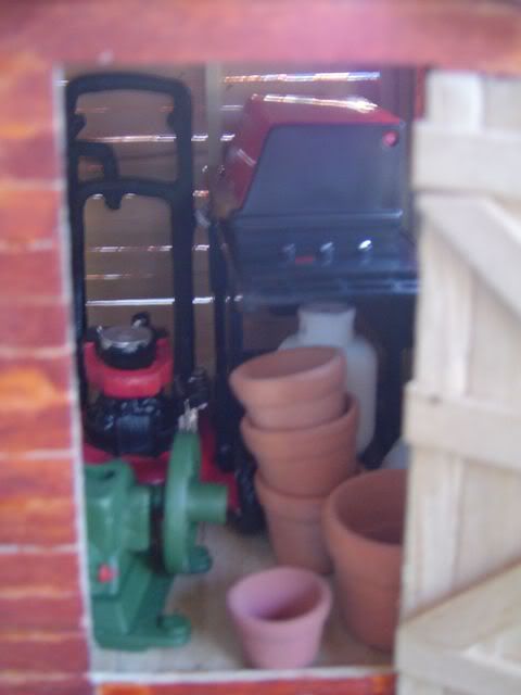

Doesn't take long to stuff sheds with junk :!:
Posted: Mon Jul 28, 2008 11:02 pm
Jon Randall wrote:Doesn't take long to stuff sheds with junk :!:
Yes they have a habit of filling up quickly :lol:
Where did you get the pots from Jon, they look nicely made. I could do with some bigger ones and cant be bothered to make my own again :roll: .
Posted: Mon Jul 28, 2008 11:11 pm
by dr5euss
I'm gonna guess LarryG, if he does pots; I see a few of Larry's other things in there :)
Posted: Mon Jul 28, 2008 11:35 pm
The small one you should recognise Steve :wink:
The larger ones are from my local dolls shop 30p for the smaller size, 40p for the larger. The are made from a clay-based material as the pieces from the first batch I bought prove :roll:
Designed for 1:12 they are about the only useful thing under a tenner I could find for 1:24 in the shop unfortunately :(
Everything else is, as George correctly said, is from Larry G, A bit large (1:19 :?: ) but gnot if hidden in a shed :D
